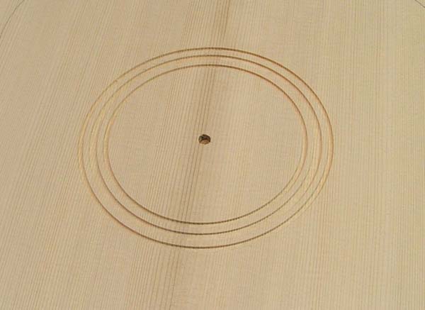

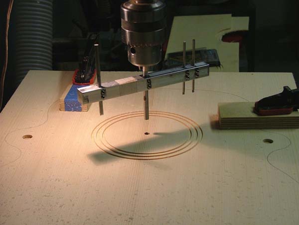

I use this little deal I made, based on something I saw at Julius Borges' shop. Works great, but it's for a specific rosette. Cheap to make. I think I have less than $20 in this one.
It cuts clean as a whistle...

Skip..right you are!    Soon they'll be big enough to go out and forage on their own, and then oh boy, the tools I'll buy!    Don, that's SWEET! Looks a little like Charlie Hoffman's, but I decided that with my limited metalsmith skills that I'd splurge on the Greven...expensive, but I do love it!

Gee Todd, that's slick, I got to try making one of those things right there.
Nice.
PostPosted: Tue Oct 25, 2005 5:35 pm
Ya, I lay everything out on cad and scale it out than print. I have access to a large formate printer and copier so I even do all my guitars this way.
